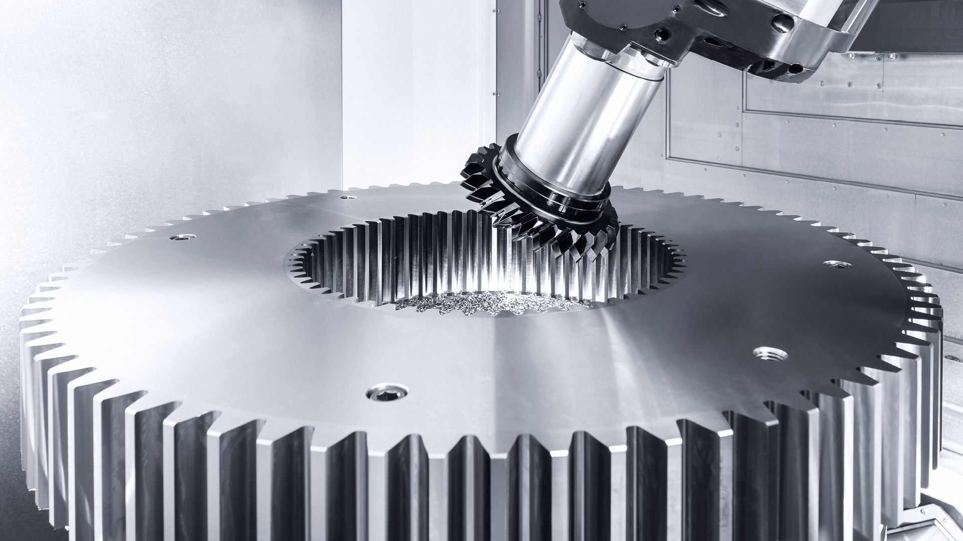

DMG MORI is kicking off the second half of 2026 with practical solutions for integrated gear machining. The gearMILL software, along with the gearBROACHING, gearSHAPING, gearHOBBING, and gearSKIVING technology cycles, enable selected gear-cutting operations on appropriately equipped machining centers, turn-mill centers, and 5-axis machines. The dialog-guided software solutions assist users in programming and executing various gear-cutting processes, thereby making it easier to get started with cost-effective gear cutting without special-purpose machines. This allows job shops and medium-sized contract manufacturers in particular to tap into new opportunities without having to outsource gear-cutting orders to external specialty firms. This reduces internal coordination efforts, shortens lead times, cuts costs, and ensures faster delivery times. However, the benefits go beyond just the added value. The possibilities for turnkey machining are also expanding: turning, milling, gear cutting, and measurement can be integrated even more seamlessly into a continuous process chain. Furthermore, turnkey machining can open the door to standard automation and pave the way for higher machine utilization rates.

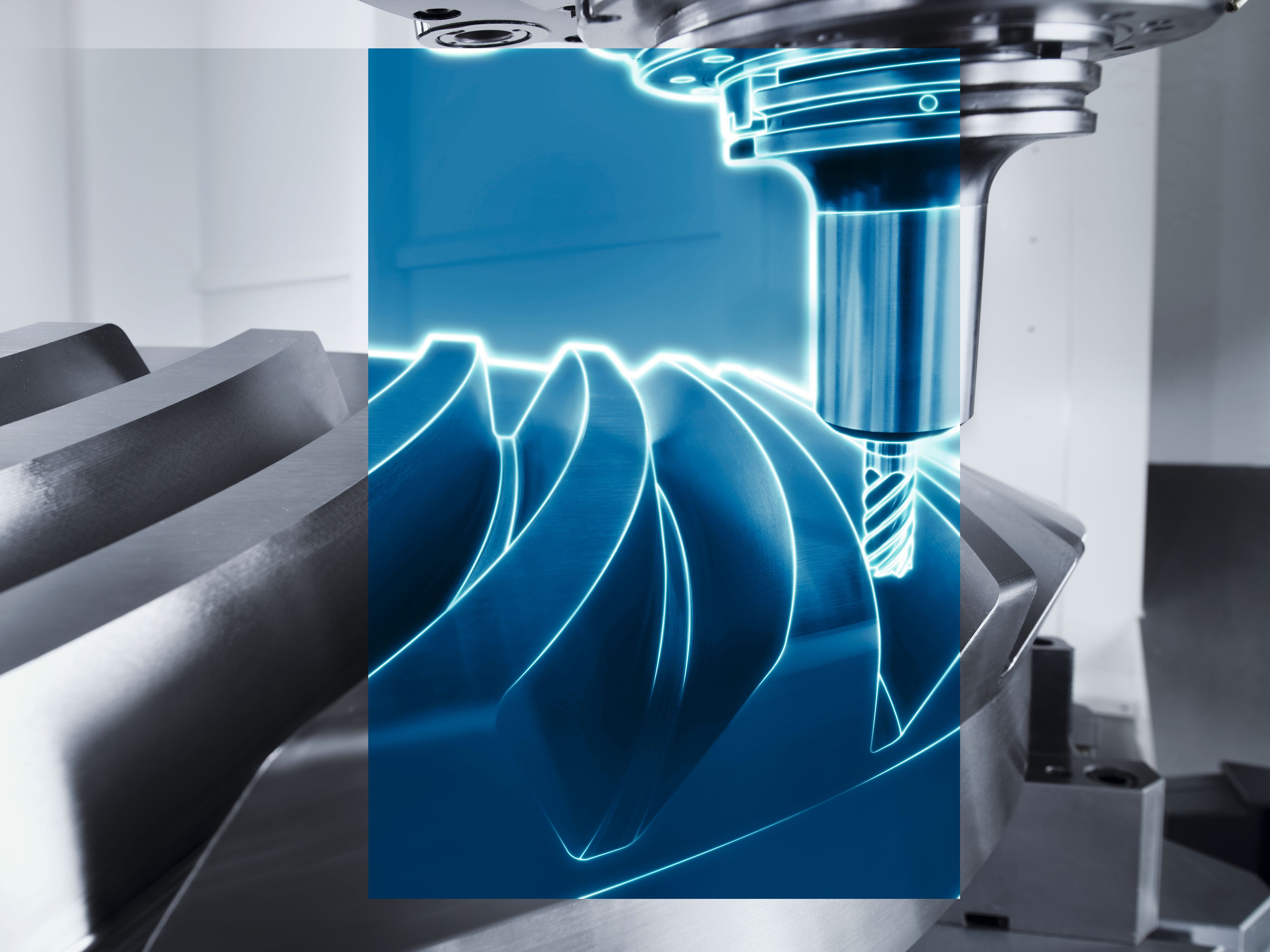

DMG MORI gearMILL: Compatibility with standard tools as well
With its exclusive technology cycles, DMG MORI enables the production of precision gears on standard machining centers.
DMG MORI gearMILL is not a technology cycle in the strict sense, but rather software for producing complex gear geometries that makes it very easy to implement custom profile and flank modifications. This also makes it easy to adapt load patterns and meet customer-specific requirements. The integrated CAM module then ensures efficient programming using standard tools. The achievable gear quality here is ≥ 5 according to DIN/ISO, which meets the requirements for prototypes, replacement parts, and small production runs in many industries.
Technology Cycles for Recurring Gear Cutting Tasks
As soon as specific gear geometries are produced on a regular basis, it’s worth making the switch to process-specific cycles. gearSKIVING 2.0 (hobbing) is up to eight times faster than conventional hobbing and enables the production of internal and external gears up to module 11 with a quality grade of ≥ 7. On turn-mill centers in the NTX and CTX TC series, this also applies to helical gears with tooth offset. gearHOBBING covers the hobbing of spur and helical spur gears. gearBROACHING is designed for position-oriented broaching of internal and external gear teeth up to module 4. And gearSHAPING supports the production of internal or external gear teeth using gear shaping. All cycles can be retrofitted as a pure software solution—on both new and existing machines.
