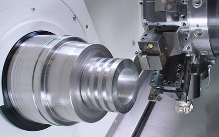

Newly revised 12 station turret with 6,000 rpm and VDI interface as standard
- High Precision Turret for the highest accuracy with 6,000 rpm, 10 kW and 36 Nm
- Main spindle with 4.000 rpm and 525 Nm in standard and 3.500 rpm and 1.194 Nm optionally available
Complete machining by optional counter spindle and star turret
- Counter spindle with up to 5,000 rpm, 32 kW and 360 Nm
- torqueDRIVE turret for powerful machining with 6,000 rpm, 23,5 kW and maximum torque of 85 Nm
- speedDRIVE Revolver for the highest demands with 12,000 rpm, 20 kW and a maximum of 56 Nm of torque optional available
Machining of workpieces up to Ø 430 mm turning diameter and up to 1284 mm turning length
- Circular diameter up to 700 mm
- Bar machining of workpieces up to Ø 104 mm
Outstanding robustness and maximum machine rigidity
- Maximum stability and long-term accuracy
- Guideways with 80mm width for higher vibration damping performance and dynamic stiffness
- Coolant circulation for all cast components for a uniform temperature shift
- Achievable quality ≤ DIN 7
- Use of regrinded tools
- Reduction of Setup time
- Setup Time reduction
