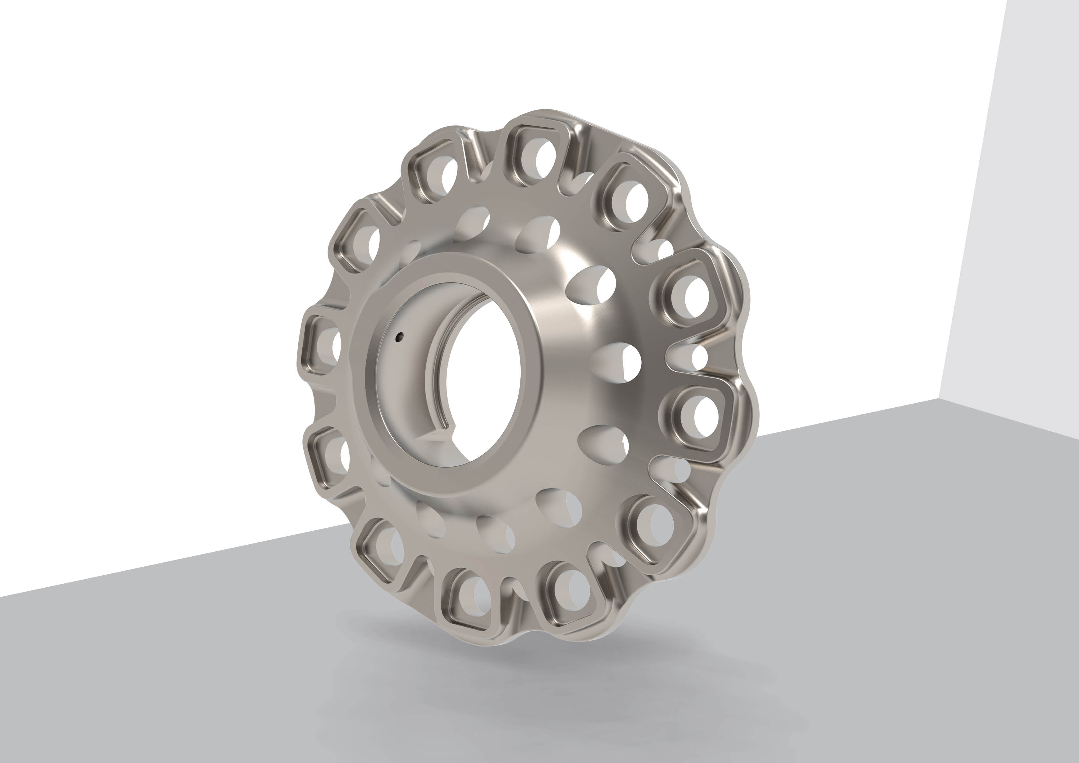

The IMOCA ocean-going yacht “DMG MORI Global One” is a symbol of precision under extreme conditions. The swivel keel’s high-load bearing requires a complex titanium component that is manufactured using a complete turn-mill machining process.
When the IMOCA ocean-going yacht "DMG MORI Global One" cuts through waves and gusts on the ocean at high speed, reliability is not optional but a prerequisite for success. There are no second chances when it comes to materials, components, and manufacturing. This is especially true for the highly stressed bearings of the swiveling keel. The showcase therefore focuses on a rear keel bearing made of titanium—a practical example of complex structural components, such as those required in aerospace, medical technology, and energy plant construction.
Precision and complex geometries
Themed image
The NTX 2500 2. Generation from DMG MORI enables complete turn-mill machining of the titanium component. Turning, drilling, simultaneous 5-axis milling, and in-process measurement, along with AI-based CELOS X widgets and technology cycles, work together to ensure a manufacturing process that is both stable and highly precise.
Titanium is considered a challenging material due to its strength, toughness, and high heat generation during machining. The component itself also requires maximum precision. At the same time, the geometry of the bearing plate of the "keel bearing" requires numerous machining steps. In a single clamping: Turning, drilling, and simultaneous 5-axis milling—supplemented by in-process measurement technology. Complete turn-mill machining operations of this kind are examples of increasing complexity and the necessary perspective on a consistent process chain.

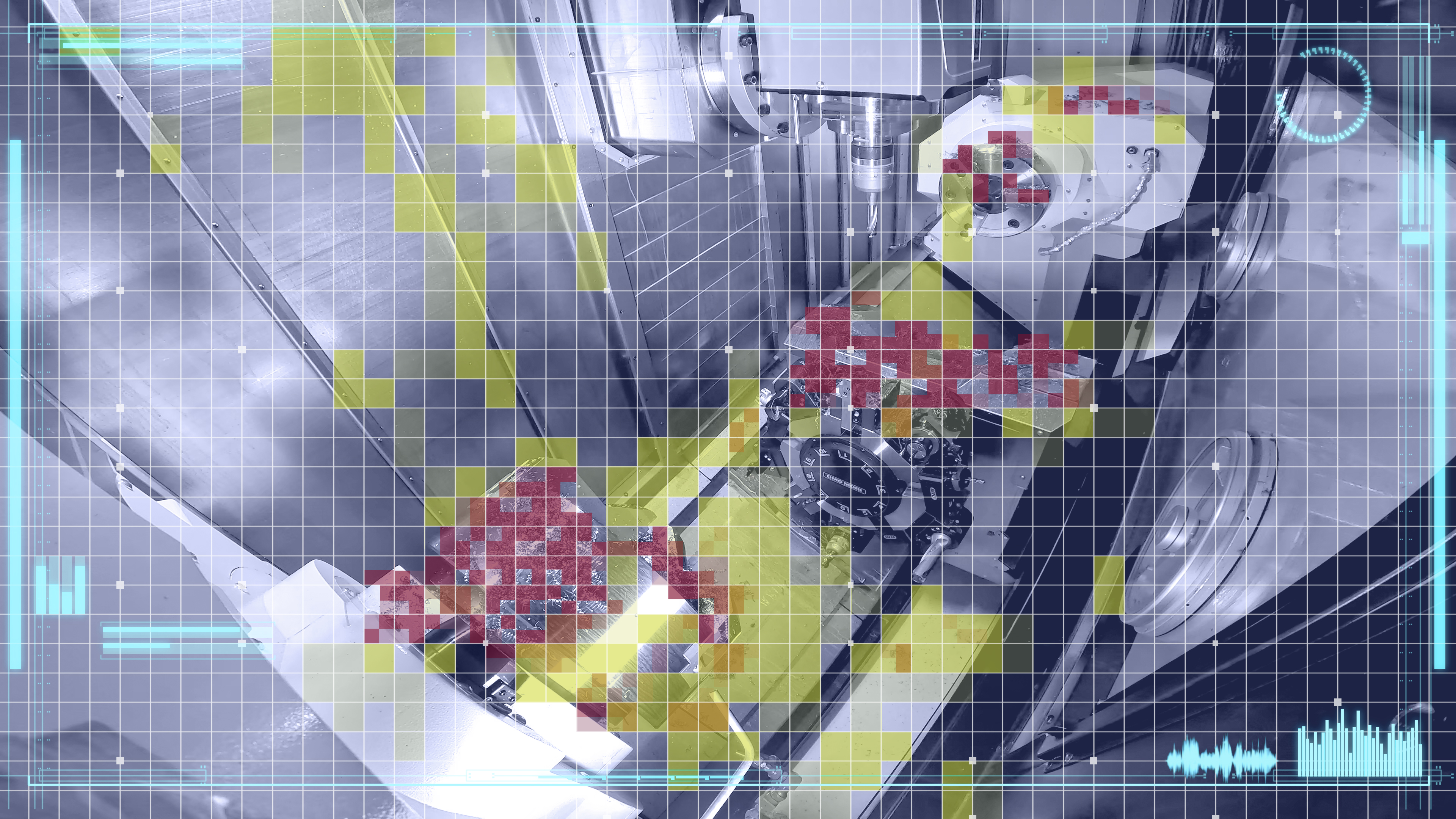

In addition, the AI Chip Removal demonstrates the automatic detection and removal of critical chip accumulations through defined cleaning movements – to reduce interruptions and stabilize machining.

    Process signals such as spindle load, vibrations, and feed behavior are recorded and evaluated. MPC (Machine Protection Control) detects unusual process conditions at an early stage and protects the machine and tool; AI Chip Removal detects critical chip accumulations and automatically removes them using defined cleaning movements.
