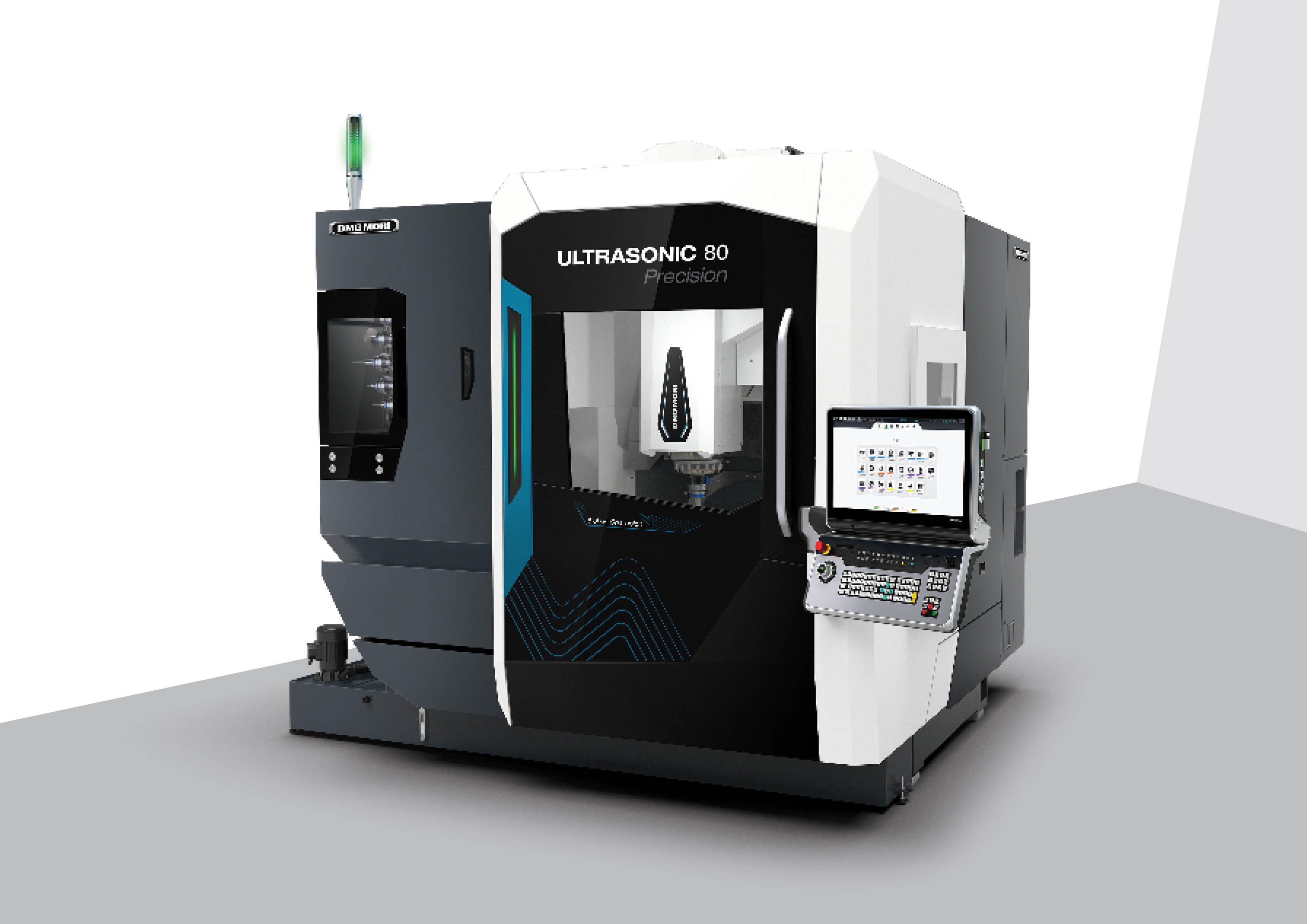

The ongoing development of ULTRASONIC technology is closely linked to rising quality requirements in high-tech sectors such as the semiconductor industry. In these sectors, the cost-effective precision machining of components—such as stage units made of Zerodur and parts made from other hard-brittle advanced materials, including silicon carbide and cemented carbides—is a decisive competitive factor. In response to the high demands of these and other key industries, DMG MORI unveiled the ULTRASONIC 60 Precision at EMO 2025. The Precision series is now being expanded to include the ULTRASONIC 80 Precision. The working area measures 800 x 600 x 510 mm and accommodates workpieces up to Ø 800 x 400 mm in size and weighing up to 350 kg.
Process Integration: Ultrasonic Milling and Grinding in a Single Setup
With a working chamber measuring 800 x 600 x 510 mm, the DMG MORI ULTRASONIC 80 Precision can accommodate a wide range of components.
The key to efficient manufacturing of these complex components is process-integrated ULTRASONIC milling and grinding in a single setup. Ultrasonic-assisted machining is the foundation for high productivity. Here, the tool is driven by a speedMASTER spindle at  20,000 rpm and set into high-frequency vibration by the proven ULTRASONIC actuator with an HSK-63 interface. The superposition of rotational motion creates a pulsating contact between the tool and the workpiece, which reduces process forces and enables controlled material removal. This reduces the risk of microcracks while increasing tool life.
The swivel rotary table, with a swivel range of -35° to +110°, enables versatile 5-axis simultaneous machining. In addition, thanks to the C-axis with direct drive and a speed of 300 rpm, as well as the standard ULTRASONIC axialGRINDING, the ULTRASONIC 80 Precision can perform reliable cylindrical grinding operations.

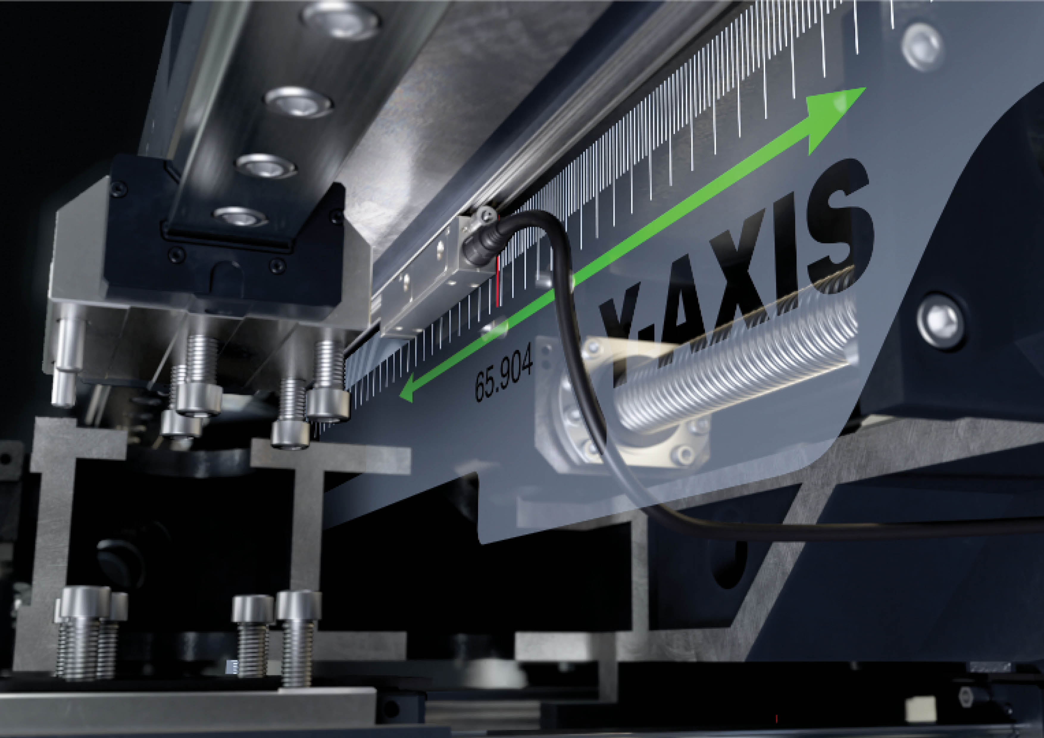

Precision: robust construction and intelligent cooling design
Wide linear guides with precision cooling systems ensure the high positioning accuracy of the DMG MORI ULTRASONIC 80 Precision.
The ULTRASONIC 80 Precision offers standard positioning accuracy of up to 5 µm and 6 µm in the circularity test. This precision is made possible by the machine’s highly rigid design and an intelligent cooling system. The monolithic machine bed, solid castings, and wide guides provide the necessary stability, while the precision cooling of the linear guides, for example, minimizes thermal deviations.
