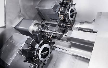

4-axis production turning with 2 turrets and counter spindle as standard
- Two 12-fold VDI 40 star turrets with 4,000 rpm, 11.3 kW and 28 Nm
- Optional Direct Drive turret with 10,000 rpm and TRIFIX precision quick-change system for highest accuracy
- Main and counter spindle with 5,000 rpm, 48 kW and 360 Nm.
Patented TWIN concept for parallel processing with 2 tool carriers
- Optimal work space utilization by working space concept with two turrets and cross stroke* of the counter-spindle tailstock combination *
- Y-axis on both turrets (up ± 60 mm, down * ± 40 mm) for the complete machining of bars, shafts and chuck parts
- Rotating diameter up to 340 mm at 1200 mm turning length
