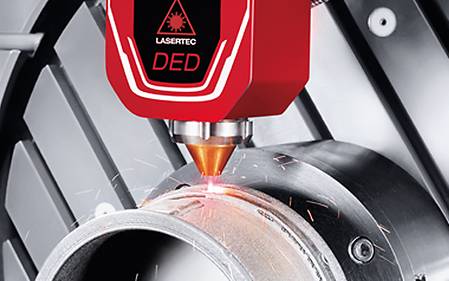

LASERTEC 65 DED Blade
ADDITIVE MANUFACTURING
High-performance additive manufacturing of metallic 3D-parts
  • Laser head integrated in the headstock for higher building volume and more additive performance
  • 5-axis material deposition by coaxial nozzle for homogeneous powder distribution, independent of direction of laser deposition welding
  • Dedicated additive solution for prototypes, small-series, repair and coating
  • Integrated thermal imaging camera for observation of the whole working area, adapive process control and constant monitoring of the working distance
  • Powder feed rate sensor as well as automatic powder calibration.
  • AM Evaluator for visualisation of the relevant process data (e. g. meltpool size, powder mass flow) as a digital 3D-model as well as in the chronological sequence
Siemens NX: Hybride CAD / CAM – Module for additive and subtractive programming
  • One software package for the complete process chain (design,
  • additive machining, substractive machining,  finishing)
  • Exclusive LASERTEC build-up strategies - fully integrated in the CAD / CAM software incl. 3D-simulation of machine and movements for collision prevention
  • Shorter time-to-market due to completete integrated PLM software integration
Completely new product design potential
  • 5-axis controlled laser deposition welding in machining centers makes new products possible
  • Improved part performance through new material combinations (e.g. Bronze + Inconel)
  • Parts with inner channels for innovative, improved cooling
