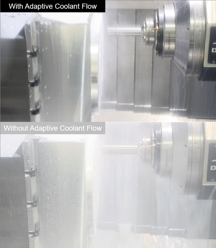

Beyond reducing energy costs and CO₂ emissions, Adaptive Coolant Flow also minimizes mist generation and coolant evaporation in the machining area, significantly decreasing total coolant consumption. This results in fewer refills, higher operability, and stable automated production, particularly during unmanned nighttime and weekend operation.
