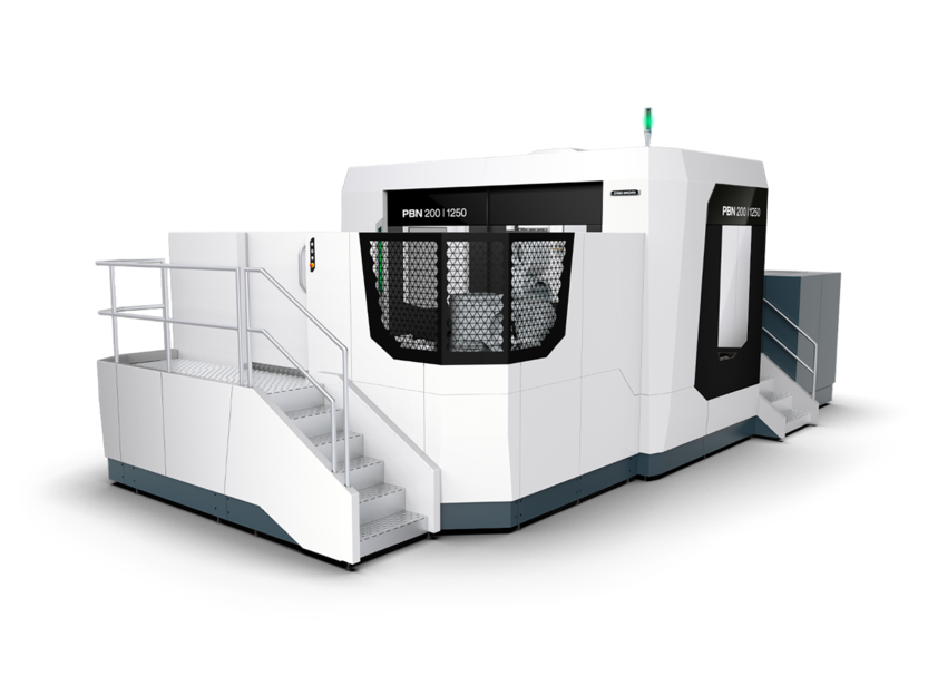

As a member of the DMG MORI Group, DMG MORI Precision Boring Co., Ltd. (hereinafter “Precision Boring“) has launched the new PBN 200 | 1250 Horizontal Boring Machining Center featuring significantly higher spindle speeds and feed rates compared with its predecessor. Leveraging Group synergies, the PBN 200 | 1250 incorporates DMG MORI-developed technologies such as an efficient chip management system, the ERGOline X control panel with CELOS X, and a user-friendly interface for reduced operator workload with enhanced shop floor productivity.

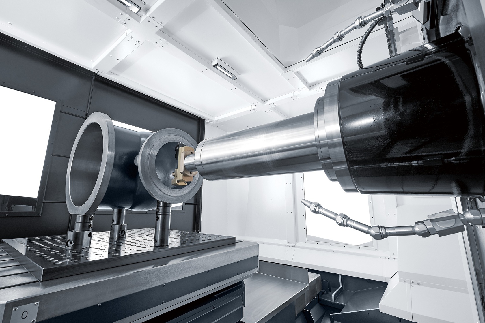

Valve machining with the W-axis
The PBN 200 | 1250 was developed to enable these operations continuously with the highest efficiency. Its high-speed boringMASTER spindle now outputs 400 V for up to 45% higher maximum output than before, reaching 80 kW (10% ED). Rapid feed rates of up to 25 m/min further contribute to shorter cycle times. To maintain high cutting performance even at maximum W-axis extension, the PBN 200 | 1250 features a Ø200 mm quill-type spindle for powerful machining deep inside large workpieces while avoiding interference, even in areas that are difficult to access using Z-axis travel alone. To accommodate a wide range of customer requirements, the PBN 200 | 1250 is also available with larger pallet sizes of 1,450 × 1,450 mm and 1,650 × 1,650 mm.

PBN 200 | 1250
1. Machine Performance & Cycle Time
  • With the boringMASTER Φ200 mm-quill spindle (400 V) for 45% higher spindle output (80 kW, 10%ED) and enhanced machining capability
  • Standard spindle speed of 10,000 min-1 for enhanced high-speed performance
  • Improved rapid feed (X/Y/Z-axis) from 16 m/min to 25 m/min for shorter cycle times
  • Improved machine rigidity for stable machining
  • Bed sliding guideway width + 100 mm
  • Column sliding guideway width + 200 mm
  • 5% higher casting mass for heavy-duty cutting with max. rigidity
  • Greatly improved cutting performance
  • Heavy-duty cutting of carbon steel (S50C): +40%*4 material removal
  • High-speed cutting of aluminum (A5052): +20%*4 material removal
