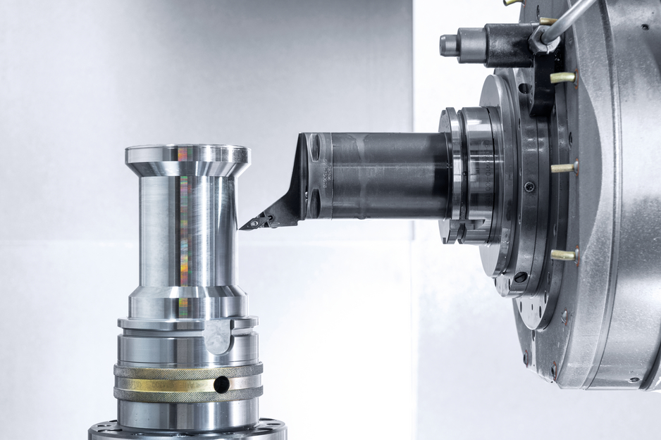

As one of the leading manufacturers of bonded grinding and dressing tools for a wide range of manufacturing industries and system solutions for the construction industry, Tyrolit has 80,000 different and often customized products for individual requirements in its portfolio. At its plant in Schwaz, the company manufactures a multitude of different diamond grinding tools, which are used in many industries including the automotive industry among others. To ensure the high quality of the tools, Tyrolit has relied on state-of-theart machine tool technology from DMG MORI in its production facilities for many years. Five lathes, turn-mill centers and machining centers are in operation in Schwaz alone. The highlight is a DMC 80 FD duoBLOCK installed in 2020, in which grinding is also integrated. A rotary pallet storage system with seven positions automates production.
Themed image Florian Zitt
Florian Zitt, Process Engineering, Tyrolit Group
Thanks to the process integration of milling, turning and grinding, throughput times have been drastically reduced on the one hand and on the other we now achieve component accuracies of less than 10 μm.

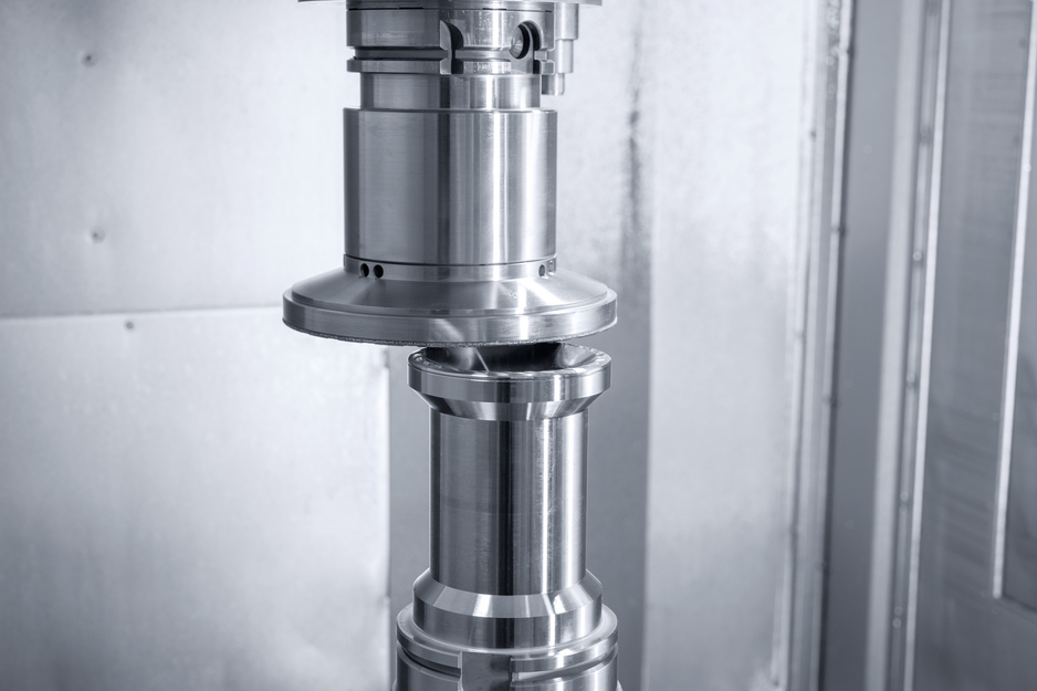

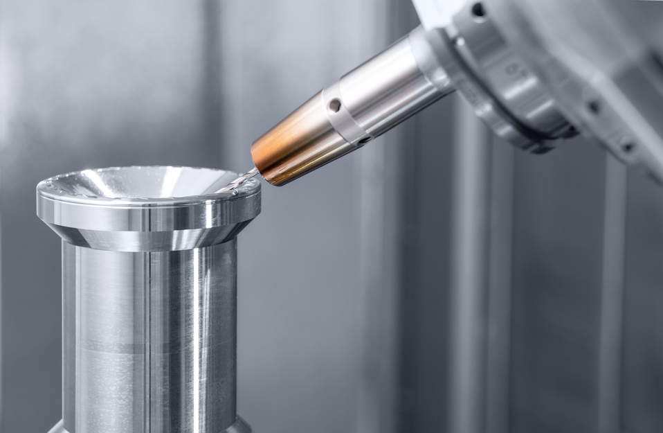

The innovative mindset is also reflected in the company’s own production. “Because it means we can manufacture most products economically,” says Florian Zitt. In view of the limited space available, manufacturing solutions are called for that integrate as many machining steps as possible in one work area. “In DMG MORI, we have found a partnerwith which we can consistently continue to develop these possibilities.” He is referring here to the integration of grinding in a DMC 80 FD duoBLOCK. Both companies cooperated in the development of this solution, which has been operating successfully since 2020. “The combination of three machining processes in one work area saves a lot of space, because we were able to replace three machines with the machining center,” says Florian Zitt, describing the conditions on the shop floor. On the other hand, throughput times have been drastically reduced because repeated setups, operations and idle times are a thing of the past. “The fact that we no longer have to reclamp components manually also has a significant impact on accuracy,” says Florian Zitt, referring to the μm-precise production of the grinding wheels, which are of course machined with diamond grinding tools from the company’s own portfolio. “The extreme durability of these products makes a significant contribution to economical and also sustainable production.”

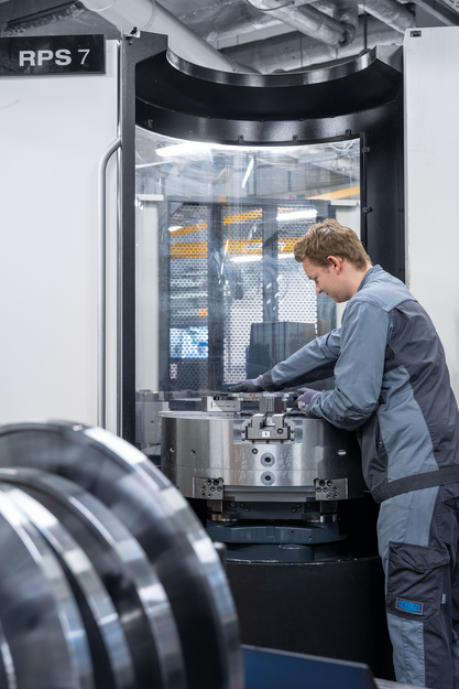

Automated production in virtually unattended shifts
The integration of grinding on the DMC 80 FD duoBLOCK was one of two new developments for Tyrolit. The other is automated production. The machining center is equipped with a rotary pallet storage system for seven pallets, so autonomous production of individual parts is possible to a large extent.
The use of electrically-actuated fixtures is for boosting the degree of automation even further in the future. Florian Zitt is sure that flexible automation solutions will continue to be a procurement criterion in the future: “They will enable us to increase our capacity for the production of small batches, including during unattended shifts.” The batch sizes at the Schwaz site are on average three pieces.
