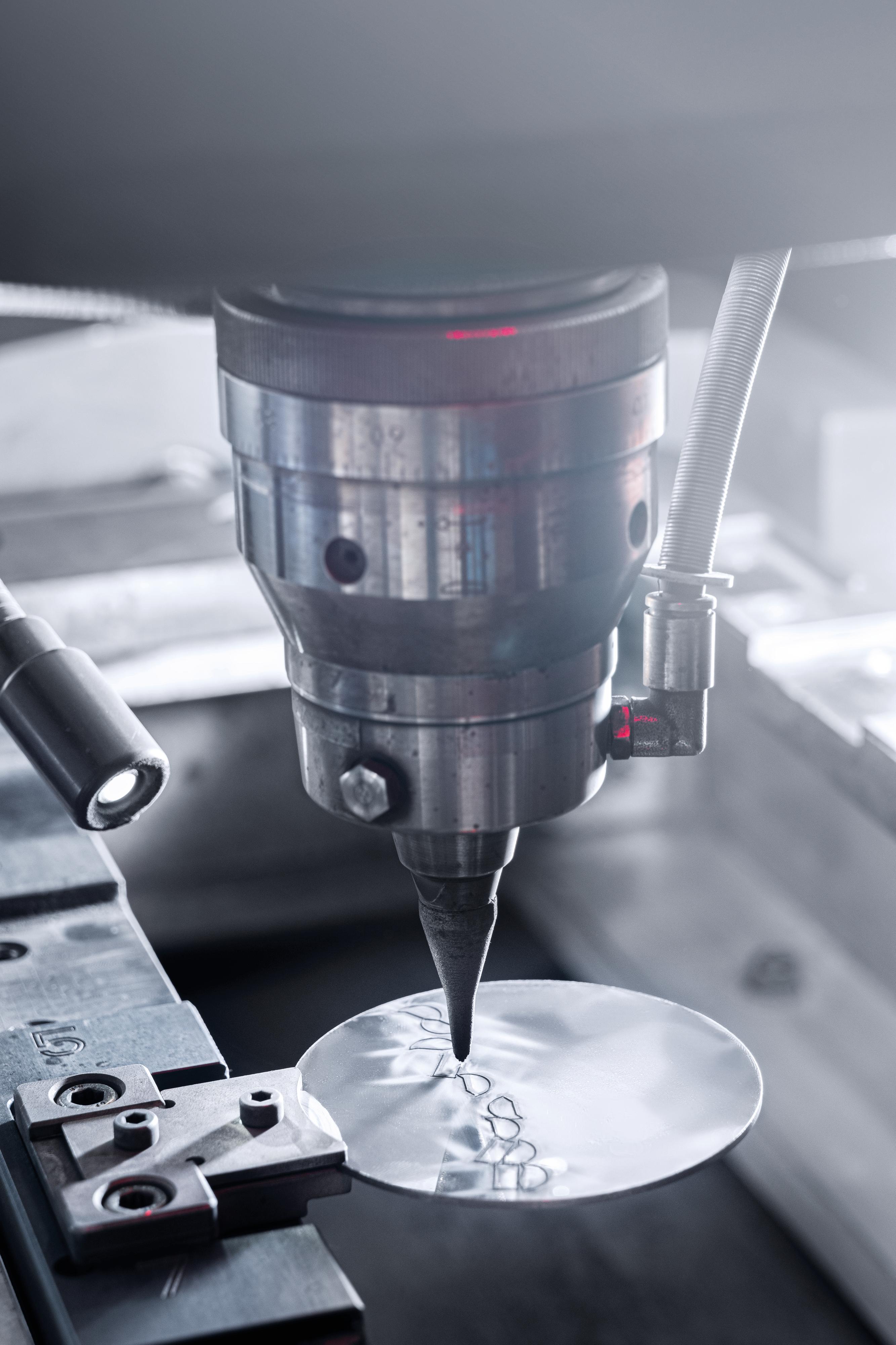

Additive manufacturing on the LASERTEC 30 SLM gives you absolute design freedom – be it cooling channels close to a contour for durability or bionic structures that provide outstanding rigidity and optimum vibration behavior. And what's more, the weight saving compared to conventional tools is between 30 and 70 percent.

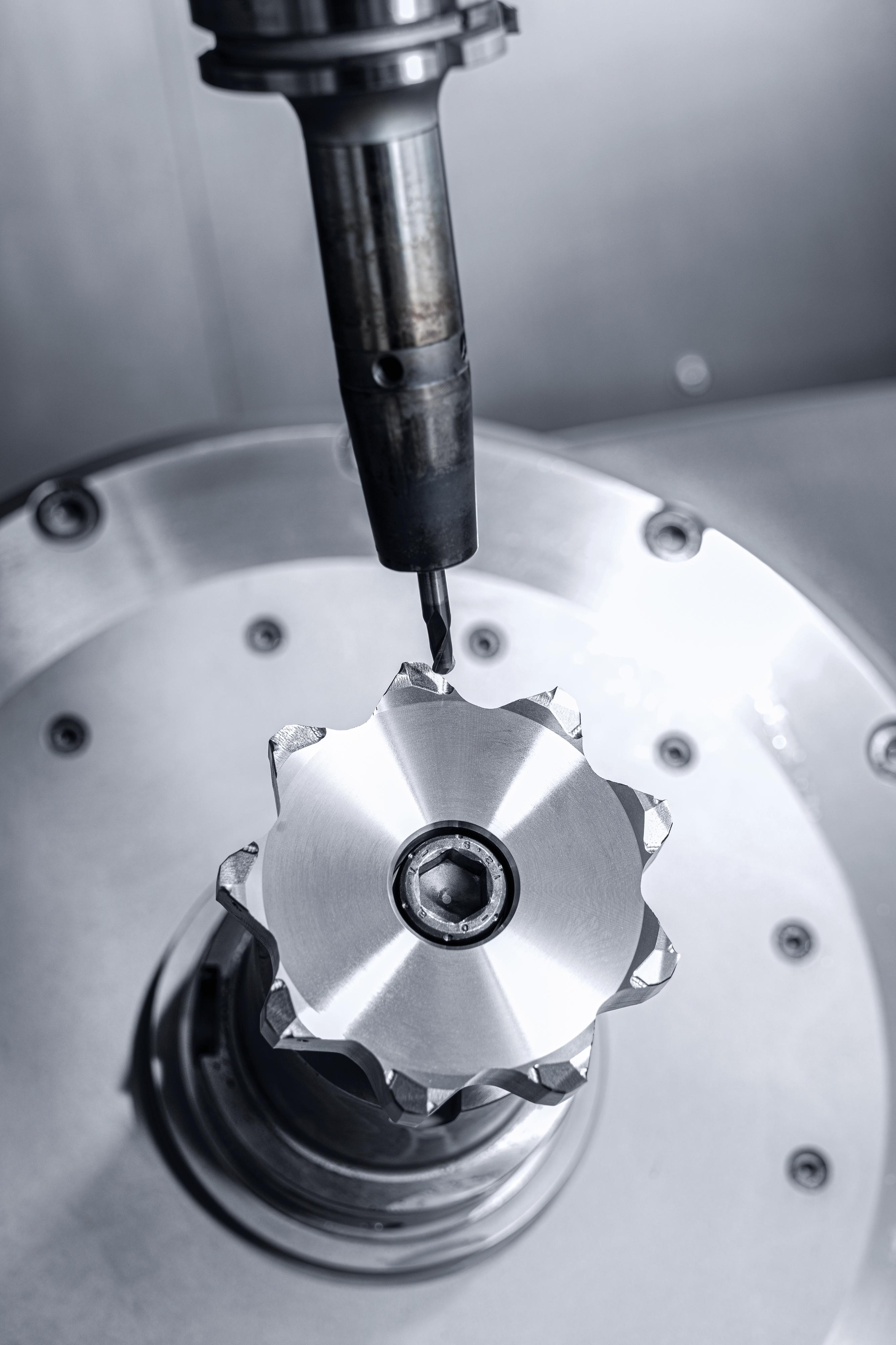

The precision machining of a stator housing, i. e. the housing in which the rotor of the electric motor rotates, requires comparatively long and therefore heavy tools. “The weight is too much to ensure low-vibration and precise machining for numerous existing machines in the way that the cutters are normally used,” says Tobias Niess, who is responsible for developing the tools, describing the challenge. The weight can be reduced in two ways: “By using lighter materials such as titanium and new production methods, but above all with the aid of innovative manufacturing technologies from DMG MORI.”

One such technology is additive manufacturing. The NEHER GROUP uses powder bed technology from DMG MORI to manufacture tool bodies – a LASERTEC 30 SLM and a LASERTEC 30 DUAL SLM. “The layer-by-layer build-up takes place directly on a previously milled interface,” says Tobias Niess. Additive manufacturing gives you complete design freedom. “On one hand we can integrate cooling channels close to the contour, which improves the durability of the tool. On the other hand, we can use the Finite Element method to create bionic structures inside the tools which provide maximum stability and optimum vibration behavior.” You also get a weight saving of between 30 and 70 percent compared to conventional tools.

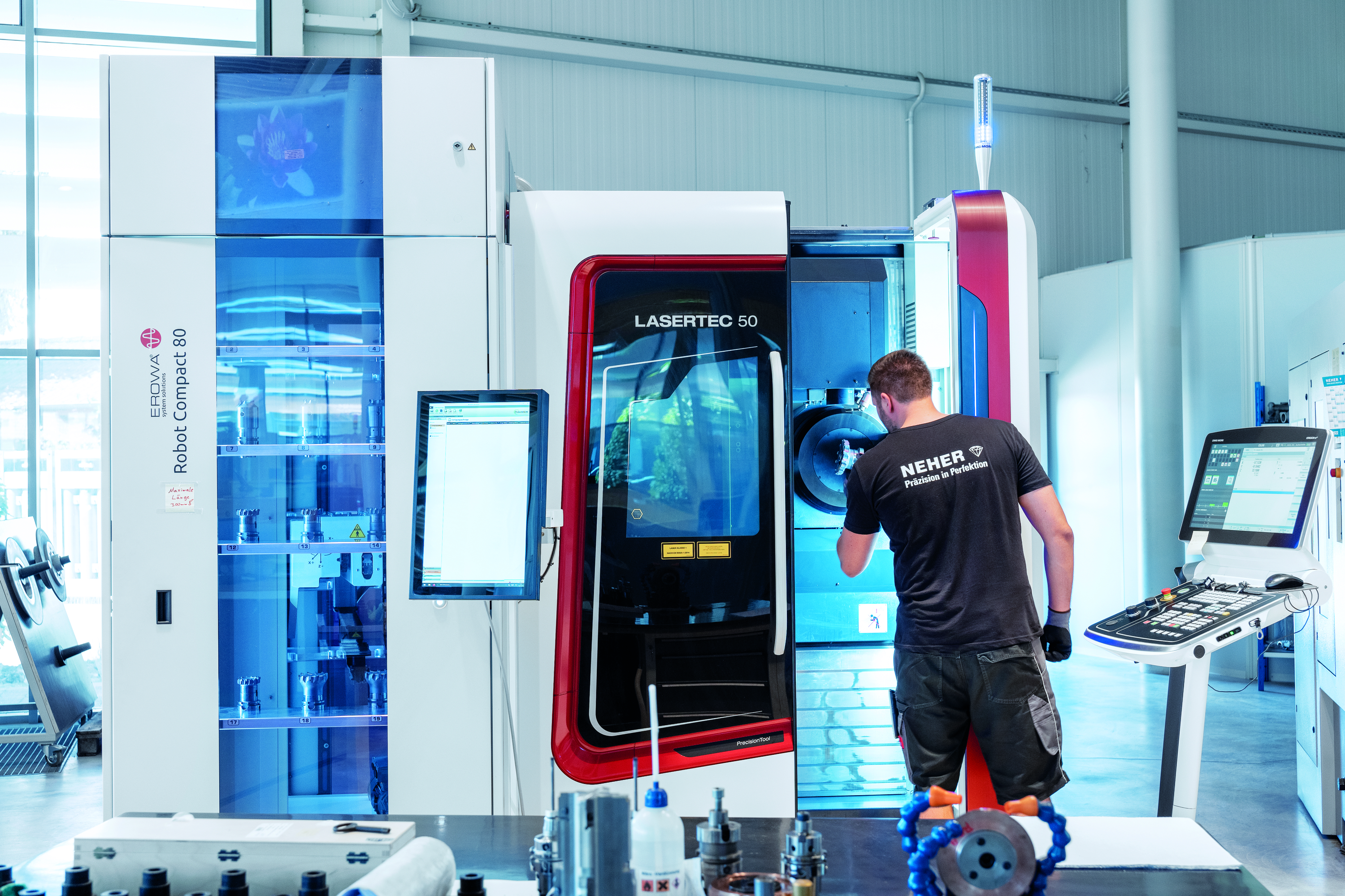

The two 5-axis LASERTEC PrecisionTool machines can economically produce 1 μm sharp cutting edges, defined cutting edge radii of 3, 6, 9, 12 or 15 μm and negative chamfers.
The cutting segments of the tools are first cut out of PCD or CVD blanks and are then brazed on. The NEHER GROUP uses a LASERTEC 20 FineCutting from DMG MORI for cutting. “The laser penetrates through blanks up to 3.8 mm thick,” says Tobias Niess. The diamond tools get their final “finishing touch” in the form of laser finishing. A LASERTEC 20 PrecisionTool and a LASERTEC 50 PrecisionTool from DMG MORI are used in this case. The two 5-axis precision laser machines can economically produce 1 μm sharp cutting edges, defined cutting edge radii of 3, 6, 9, 12 or 15 μm and also negative chamfers. Thanks to High Speed Mode 3.0, the laser can operate at speeds of up to 3.0 mm/min. The technology is therefore up to 210 percent faster in comparison to spark erosion (EDM) and unit costs are reduced by 56 percent. The service life of the tools is increased by a factor of 2.5 thanks to laser processing.

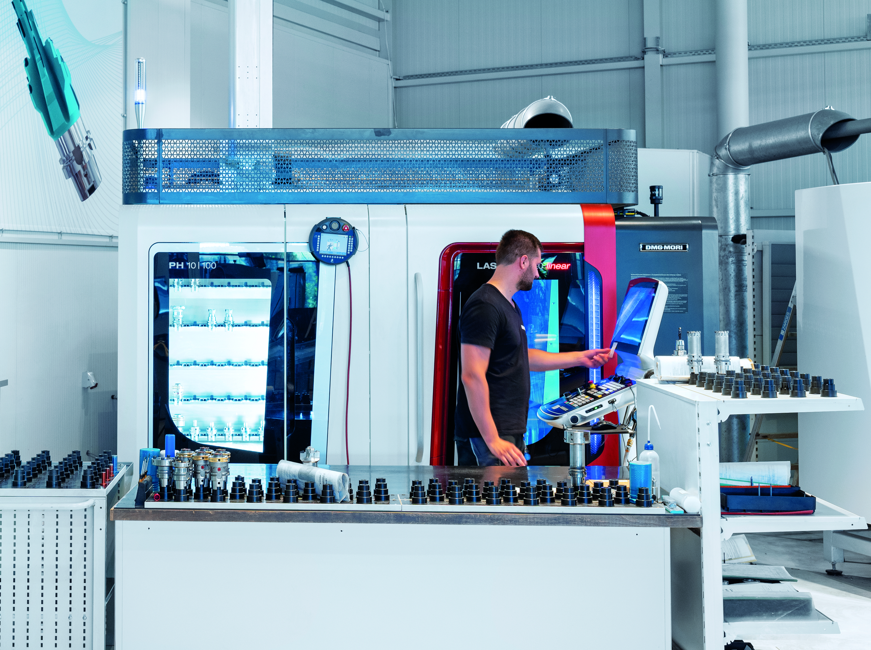

The cutting edges are processed even more economically thanks to the automation solutions installed by DMG MORI. For example, the LASERTEC 20 PrecisionTool has a PH 10 handling system with space for up to 54 HSK tools. The LASERTEC 50 PrecisionTool is equipped with automation that can change tools weighing up to 30 kg. “In this way, we can utilize both machines unmanned at night and at the weekend,” adds Tobias Niess.
