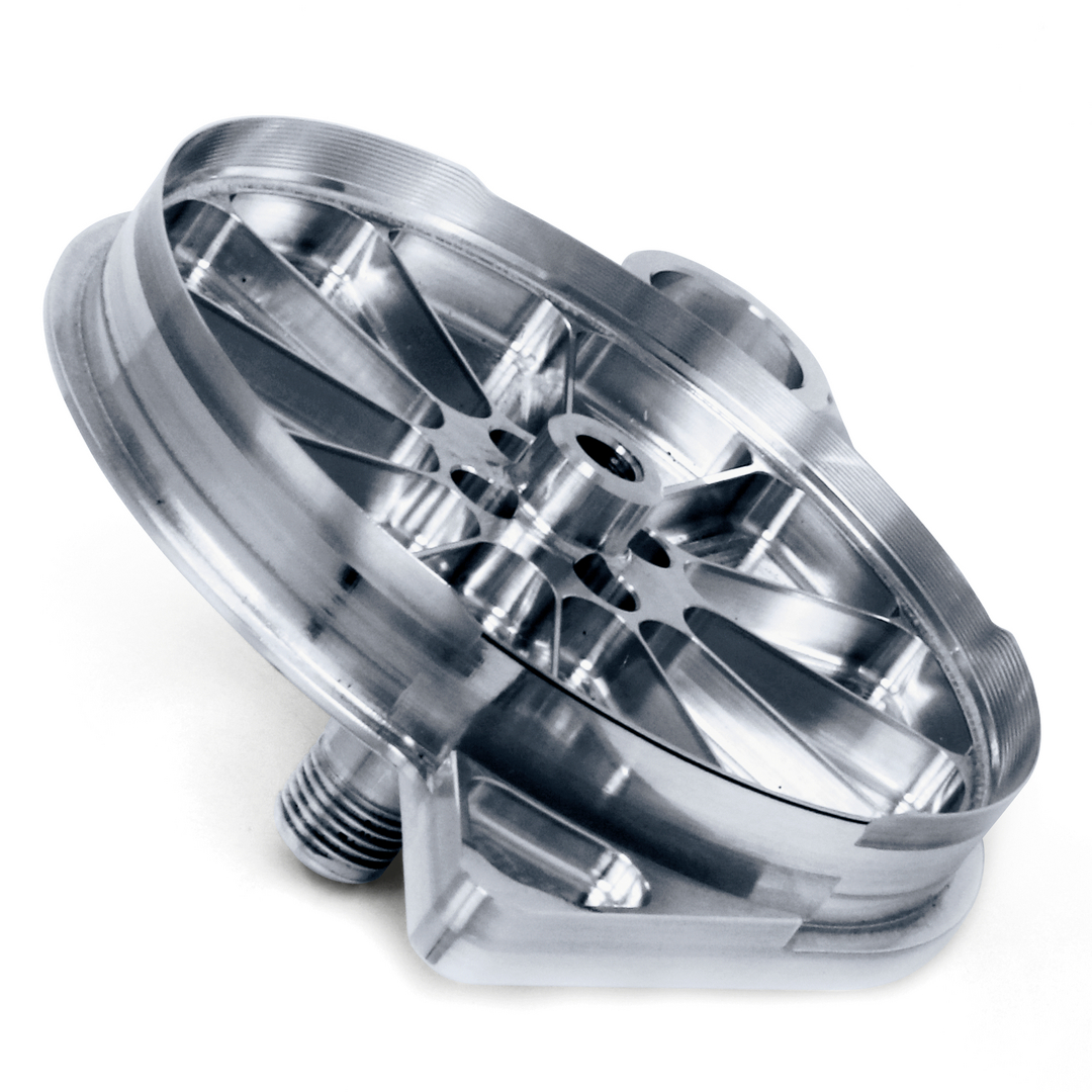

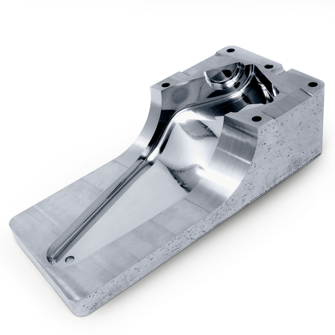

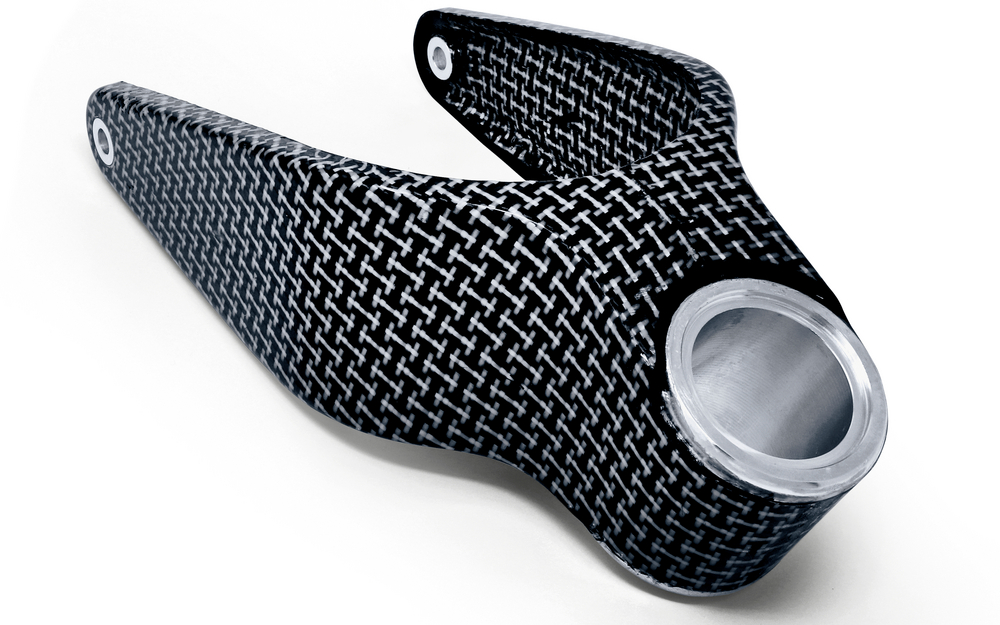

At the same time, the company also uses its technical know-how to help customers that require high-precision and complex components for demanding industries, such as the medical sector. NASHERO uses machine tools from DMG MORI to efficiently manufacture such products, which are made of steel, aluminum, titanium or carbon fiber, amongst other materials. In 2017, the company installed an automated DMU 50 3rd Generation equipped with the Digital Manufacturing Package.

Dr. Naresh Sharma dreamed of developing safe, efficient and faultless aircraft. “The development was based on our many years of experience in the aerospace industry,” he says looking back to the early days. “The experience we gained showed us what beneficial and desirable safety features were needed.” Today, the team has exceeded its initial dream. In addition to a light sport aircraft, the company also offers state-of-the-art production technologies to OEMs in the aerospace industry. “We placed great value on keeping all processes in-house to ensure we had complete control over the quality of our work,” explains Dr. Sharma. The requirements are extremely high, as NASHERO manufactures complex parts in small quantities and to tolerances right at the limit of the capabilities of the machine tools.
