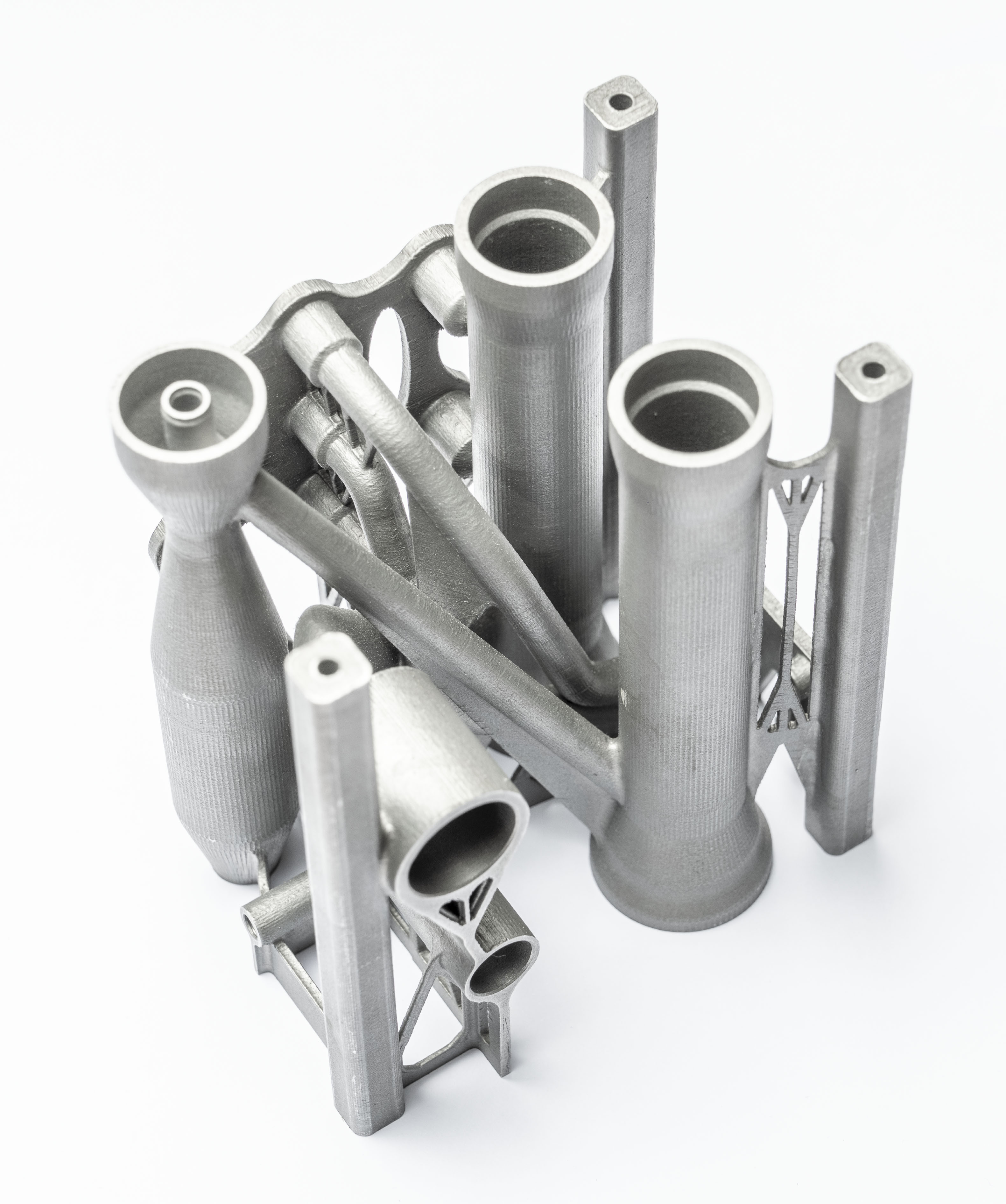

Peter Perremans uses the example of a hydraulic block to illustrate the additive approach: “Instead of a solid block with straight holes, we can use 3D printing to freely determine the course of the fluid channels, which improves the function and drastically reduces the weight of the component.”  Lightweight construction is a decisive factor in the Aviation & Space sector, among others, but stability must also be taken into account. “We could produce wall thicknesses of just 0.5 mm on the LASERTEC SLM machines, but this is not enough for some applications.”

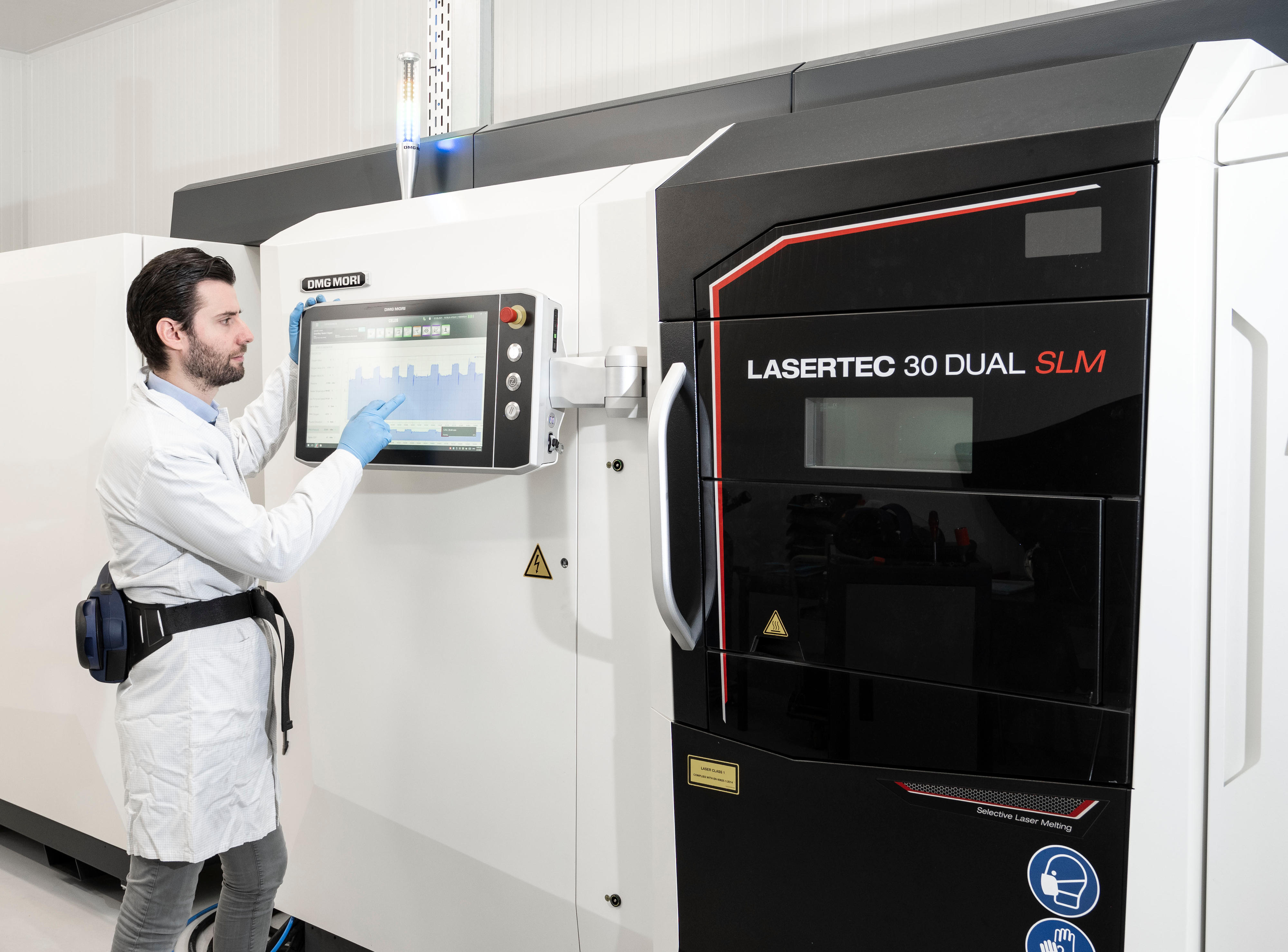

Thomas Vandenberghe, SLM engineer at Melotte, gives another example of successful redesign with cooling channels for lithographic systems from ASML: “On the LASERTEC 30 DUAL SLM, we can freely define the geometry of these parts and thus optimally adapt them to their later function.” In order to produce these variant-rich small series economically, Melotte places as many of the components as possible on one of the 300 x 300 mm build plates. Peter Perremans also sees a sustainable aspect in such newly conceived solutions: “The bionic design of these components requires significantly less material than conventionally manufactured components that are milled from solid material.” This supports a resource-saving approach to production.
High-precision and 80 percent more productive

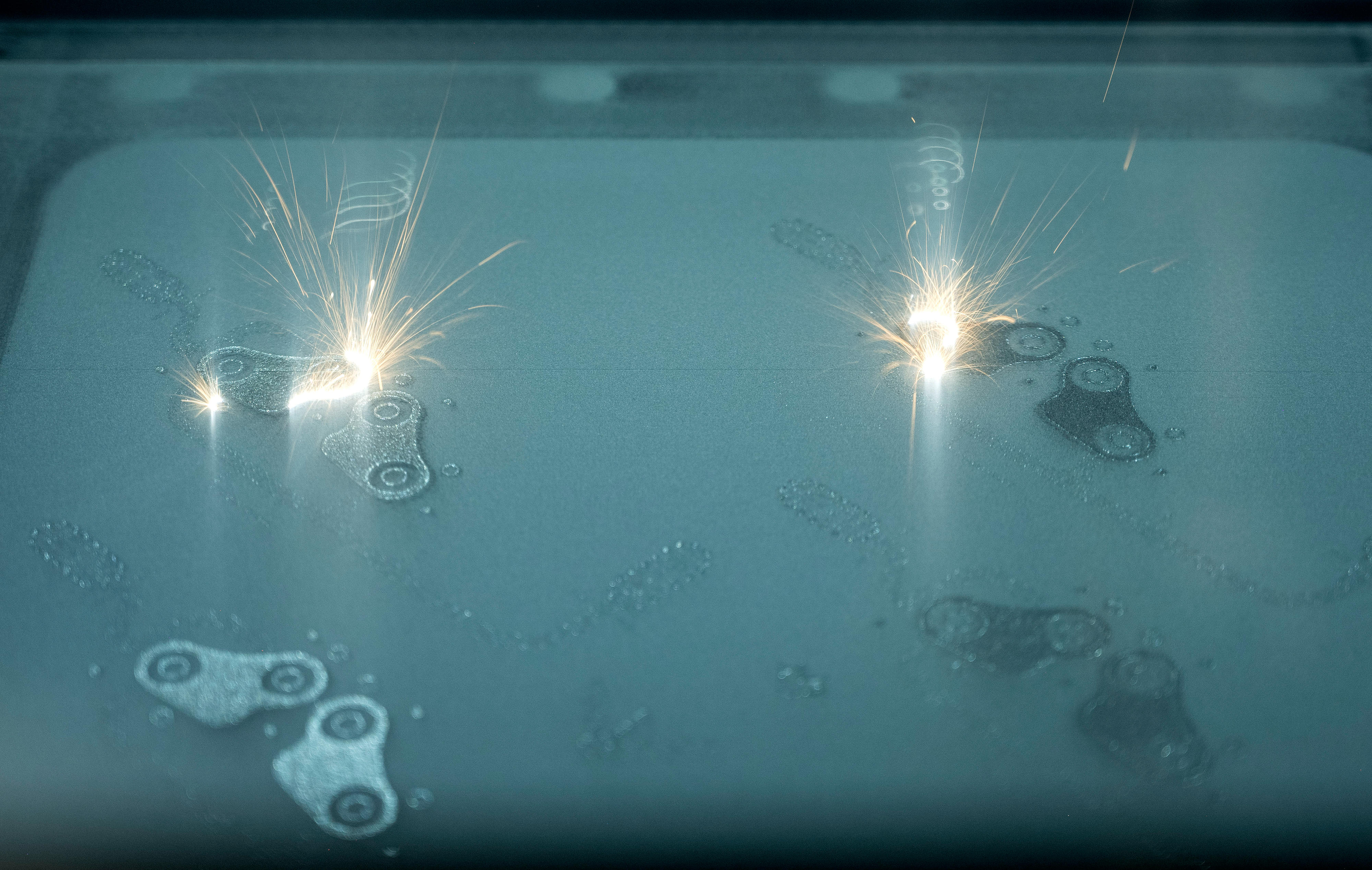

Melotte's decision to invest in another LASERTEC SLM machine in 2024 is partly due to the positive experience with the previous models. On the other hand, Thomas Vandenberghe was also impressed by the potential of the LASERTEC 30 DUAL SLM: “Equipped with two 600 watt lasers, the machine is up to 80 percent more productive.” DMG MORI has also further improved the optics module. “The focus diameter of 80 µm offers very high precision, which allows us to produce extremely fine grid structures with good surfaces, for example. This means we always get the best component quality.”

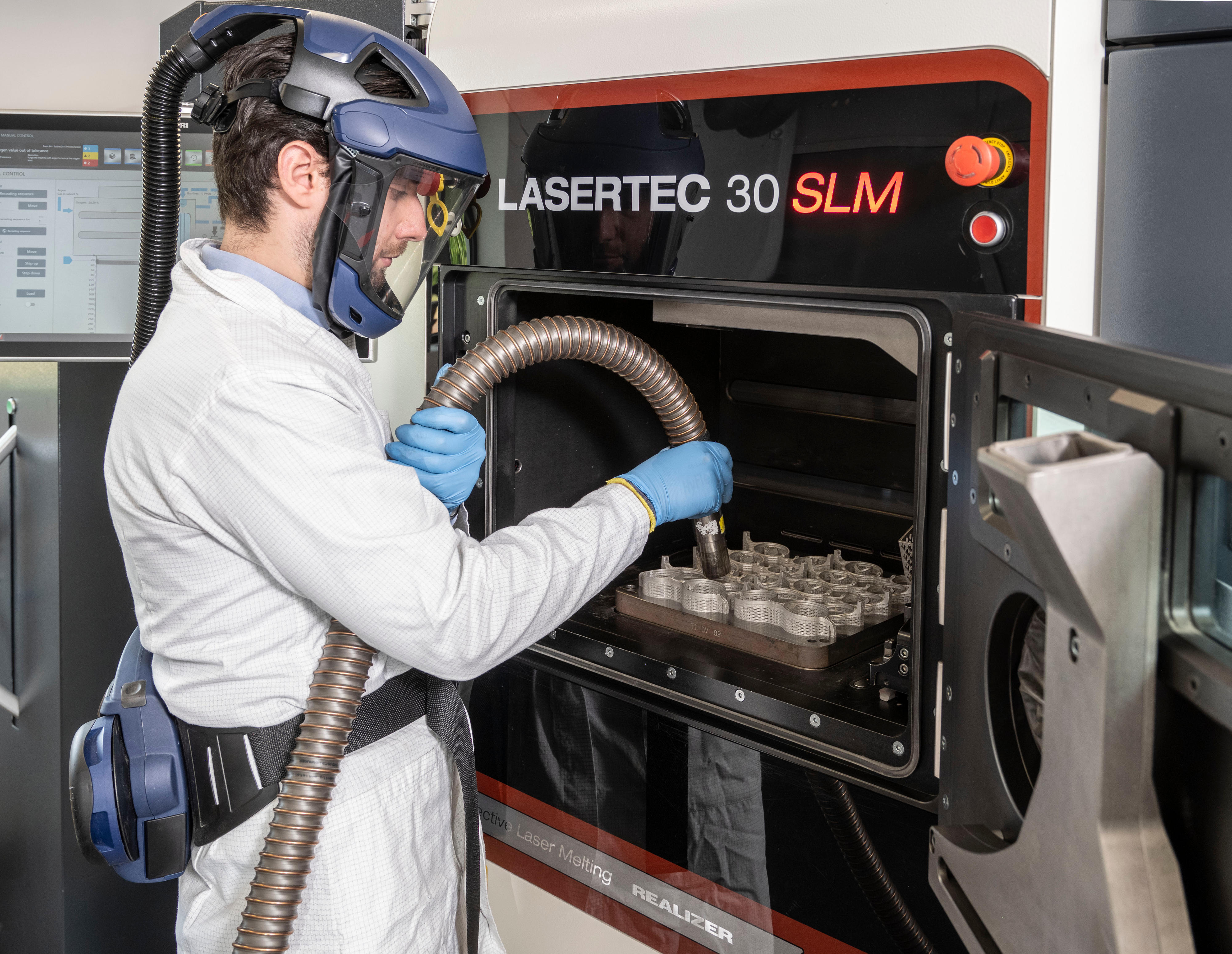

Convenient powder handling with rePLUG exchangeable module
On the LASERTEC 30 SLM and the newer LASERTEC 30 DUAL SLM, Melotte mainly produces components made of stainless steel and titanium alloys. According to Peter Perremans, the consistent use of the same material reduces the effort involved in cleaning: “Customers such as ASML expect absolutely unmixed products without residues of a different material. In this case, all lines must also be cleaned when changing materials.” Should this ever be necessary, DMG MORI has a convenient solution with the rePLUG change module, which enables a contamination-free changeover between different materials in under two hours. “We can provide replenishment with the same material in just a few minutes.”
