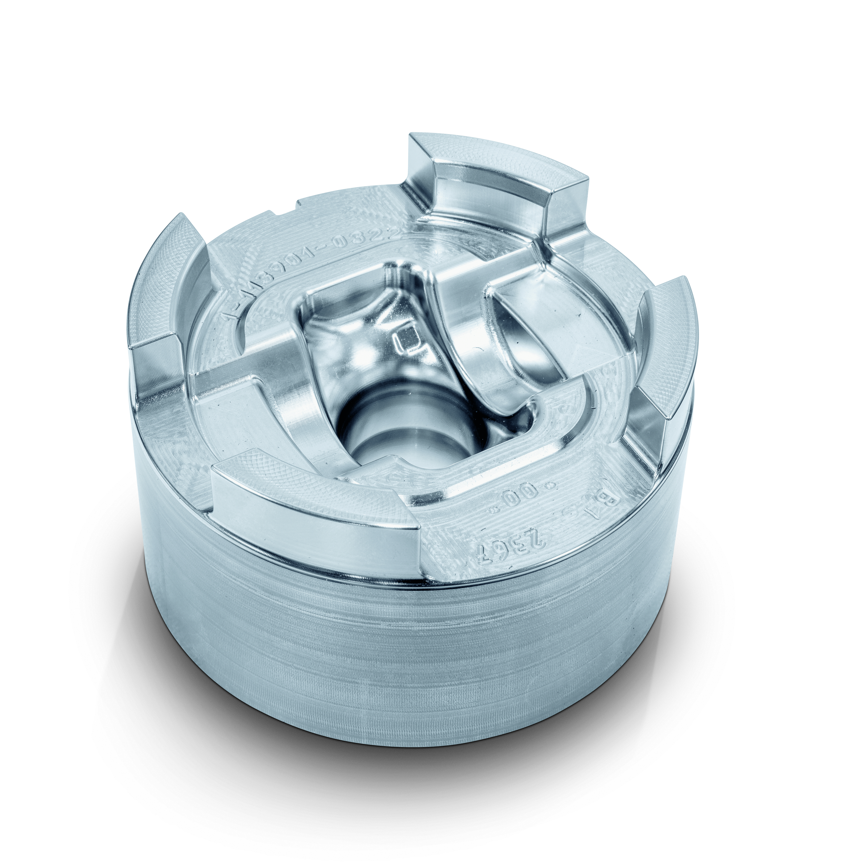

Their headquarters in Denklingen – the company was founded here in 1938 – is also the headquarters of Hirschvogel Umformtechnik GmbH. Countless components are produced here using hot, cold, or warm forging. Around 200 skilled workers manufacture the necessary molds on site in the tool shop. Automated monoBLOCK machining centers from DMG MORI ensure flexible and efficient manufacturing of the complex components. The latest installation is a DMU 85 H monoBLOCK with PH Cell 2000.

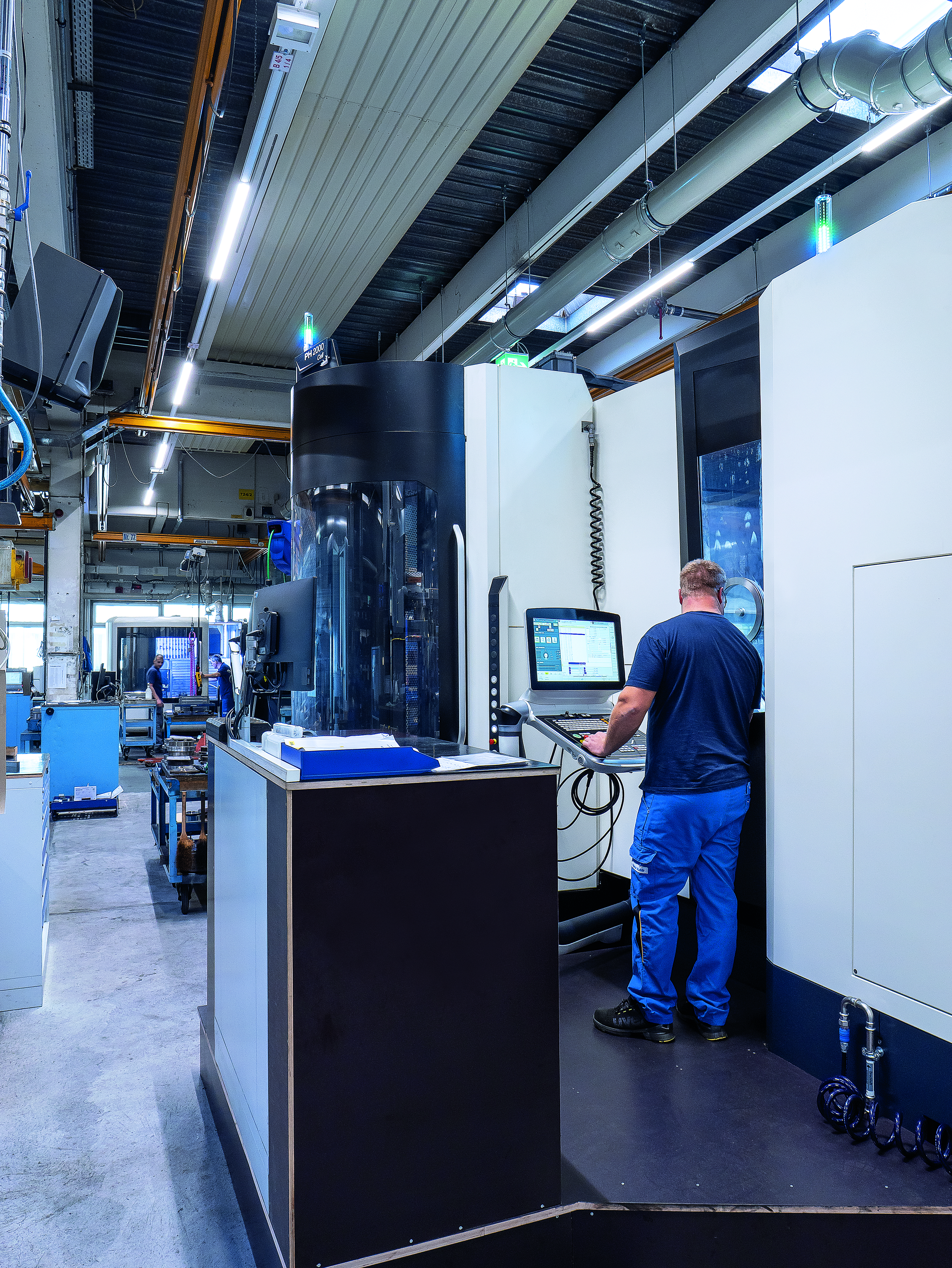

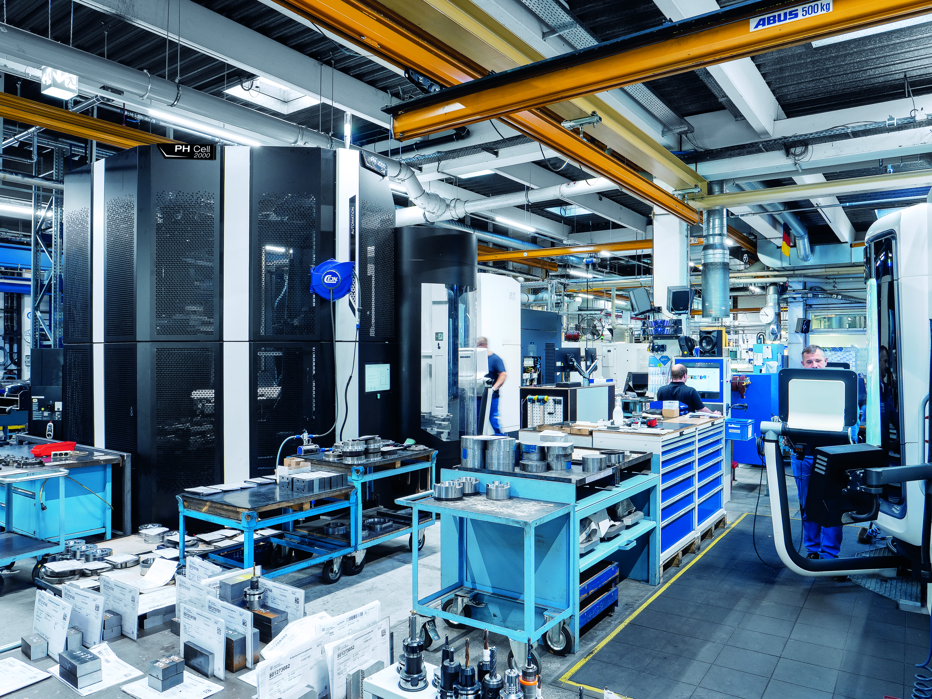

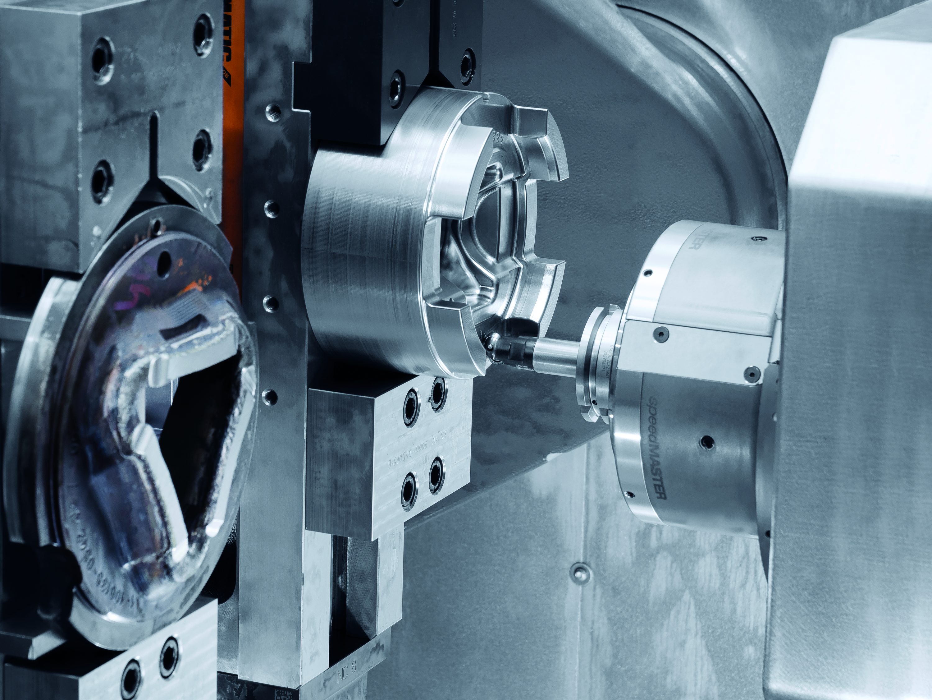

The latest installation for toolmaking by Hirschvogel is a DMU 85 H monoBLOCK with PH Cell 2000. The horizontal spindle of the machining center offers two decisive benefits, Matthias Lenggeler, foreman in the area of toolmaking milling, says explaining the acquisition: “On the one hand, the vertical chip fall ensures high process reliability and, on the other, the vertical travel path is considerably larger.” The versatility of the machine is ideal for the diverse range of parts used in toolmaking. “We mainly machine individual parts or very small series,” Matthias Lenggeler says describing their daily business. The automation solution needs to be just as flexible. The PH Cell 2000 was designed by DMG MORI with just this flexibility in mind. The modular storage system offers up to 21 pallet spaces, depending on the size of the pallet. Hirschvogel uses pallet sizes of 630 × 630 mm, which enables 17 spaces. A further advantage according to Matthias Lenggeler: “The positioning of the pallets on three levels ensures a compact footprint.” The PH Cell 2000 only needs a footprint of 16.5 m².
Easy operation thanks to CELOS with Pallet Master
A further feature of the PH Cell series is the simple commissioning within just a few days, thanks to a defined interface and the modular construction kit. The CELOS-APP Pallet Master takes care of the control system directly via the machine control or the optional additional control panel. The PH Cell 2000 is designed for machining larger components. It can handle a transfer weight of up to 2,000 kg. “This gives us the option of not only machining smaller molds, but also larger mold components,” adds Matthias Lenggeler. “Depending on requirements, we can alternatively load a pallet with clamping devices for several components.”
