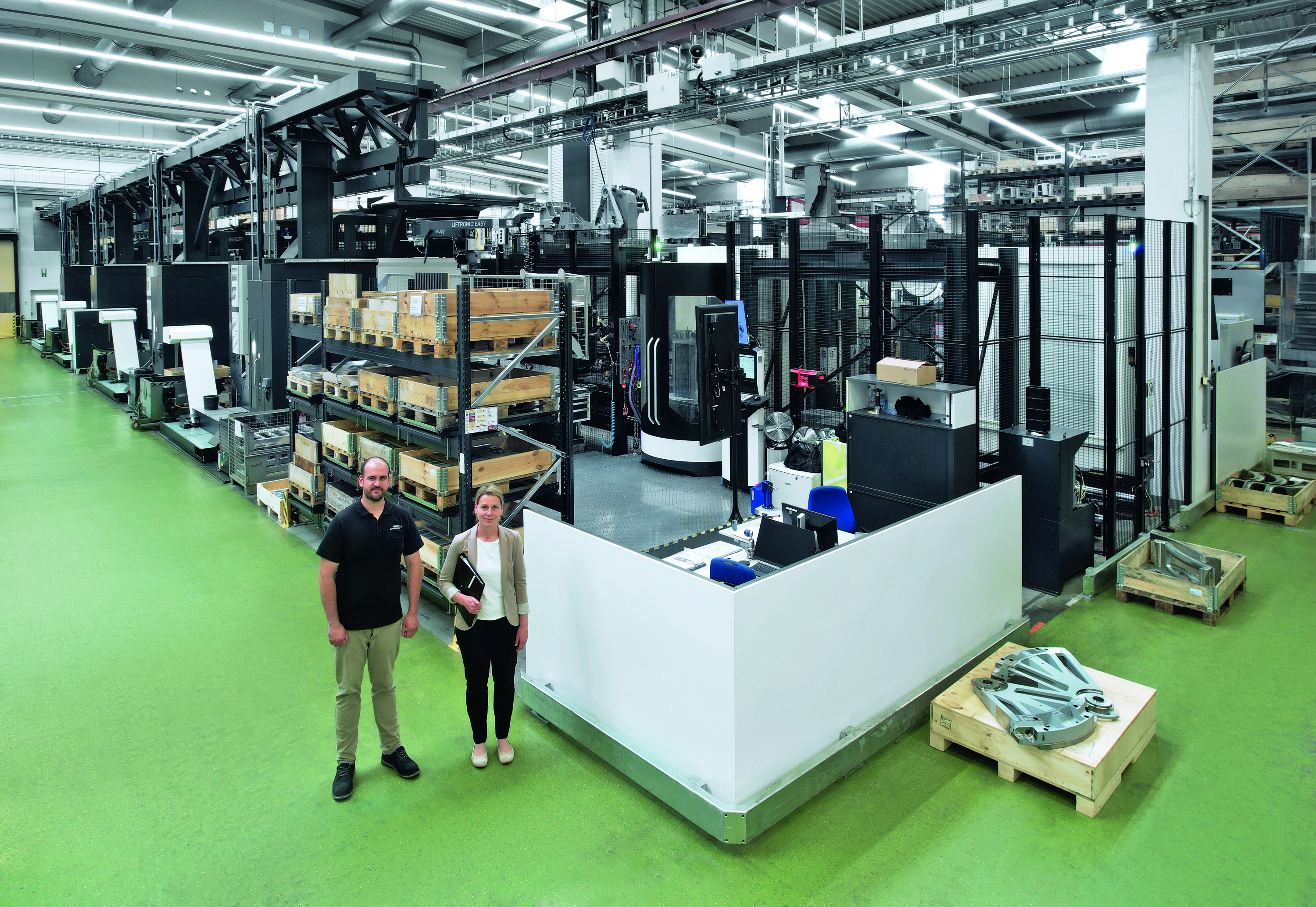

The Siemens Healthineers AG factory at the Kemnath site in Upper Palatinate was established in 1962 and has developed from a purely contract-based manufacturer into a Center of Competence for mechatronics. The workforce of about 1,200 employees manufactures many of the components for the leading medical technology provider’s product range. Among other things, the portfolio includes computer tomographs, MRI devices and radiotherapy products. In order to remain competitive, in 2021 the company started to analyze all of its production lines to identify problems and find solutions. As a result, a flexible production facility with four DMU 125 P duoBLOCK machining centers was installed in 2024 by DMG MORI. These machines operate with a high degree of automation via a linear pallet pool (LPP)and are supplied with tools via Central Tool Storage (CTS).

We succeeded in more than doubling our productivity with the new manufacturing system from DMG MORI. Thanks to the LPS 4 master computer, the entire system is completely networked with our own systems.
Leopold Schmidt Head of Machining Technology Planning Siemens Healthineers Mechatronic Products
Responsible for the instigation of competitive manufacturing in the Kemnath mechanics center – Leopold Schmidt from Siemens Healthineers and Regina Kirchhofer from DMG MORI.
