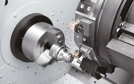

  • 13 models for a wide range of workpieces: Spindle 8-inch chuck,
    turning / milling / Y-axis specification / spindle 2 specification
  • Distance between centers 300 / 500 / 1000 / 2000 type
  • The ALX 2000| 300 (turning specification) featuring a space-saving footprint of 2.7 m2 (29.1 ft2) can be placed in the existing CL2000 installation area
  • Rapid traverse rate (X-, Z-axis): 30 m/min (1,181.1 ipm) <25% faster than the CL> to reduce cycle time
Cutting-edge technology for high rigidity and high accuracy
  • Latest in-house made DDS (Direct Drive Spindle) turnMASTER
  • Slideways on the X-axis for higher damping performance, and linear motion guides on the Y- and Z-axis for improved positioning accuracy
  • Full closed loop control (Scale feedback) SmartSCALE as an option: Enhanced positioning accuracy
High-quality, High-performance Spindle turnMASTER
  • 3-year guarantee on the reliable turnMASTER
  • Our in-house manufactured built-in motor spindle, with DMG MORI’s long years of technological know-how, demonstrates overwhelming excellence in heavy-duty cutting that requires rigidity
  • The labyrinth structure has been enhanced, taking into account frequent use of high-pressure coolant
  • Prevent coolant entry and improve spindle durability
