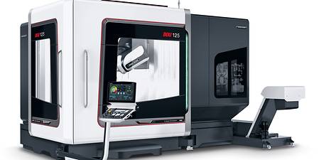

In future the DMG MORI series of high-precision DIXI machining centers from Le Locle will start off with the DIXI 125.

DMG MORI has extended the high-precision machining centers in the DIXI series to include the smaller DIXI 125 for workpieces with diameters up to 1.250 mm. Like its bigger sister models, this world premiere also impresses with its unparalleled volumetric accuracy. The basis for this are the manually scraped guide contact surfaces with flatness and straightness values of 3 µm when mounted and a perfect machine structure that makes it possible to limit geometric tolerances by up to 80 percent. Positioning accuracy in the X-, Y- and Z-directions are 4 µm, 3 µm and 4 µm respectively and 4 arc seconds for the B- and C-axes. Volumetric accuracy is not measured until the machines are installed on site and is less than 15 µm. Users can get this impressive degree of accuracy for an additional price of around just 20 percent compared to standard machining centers in this class.

A 980-liter coolant unit with reference-guided temperature control of the feed drives, guides and machine structure plus a powerful machine cooling unit guarantee the extreme thermal stability of the DIXI 125. The thermo shield and individual thermal compensation including spindle growth sensor contribute additionally to this high level of thermal stability.
Based on the 4th generation duoBLOCK the DIXI 125 as the smallest model in the DIXI series nevertheless offers a generous work area of 1,250 x 1,250 x 1,150 mm. The NC-controlled rotary table has a maximum load capacity of 2,000 kg.
