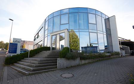

ubc GmbH
Since about 20 years, ubc has been producing carbon parts for motor sport and automotive industry.
Die ubc Composites GmbH from Murr in Germany is one of the partners of the Porsche team in the LMP1 class, which plays a vital part in the building of the Porsche 919 Hybrid. The company’s 150-strong workforce is contributing many years of expertise in the processing of carbon to the success of the racing team. For 20 years ubc has been constructing and producing complex components made from the powerful carbon fibres - for motor sports as well as production vehicles like the current Porsche GT3 RS. ubc achieves reliable quality and flexibility with professional competence, 100 percent vertical integration and usage of state-of-the-art technologies. The same applies to chip removal: Three machining centres of the DMU series of DMG MORI set standards with regard to productivity, versatility and accuracy.
ubc GmbH
