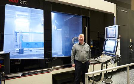

Ewald Baumeister, Head of the Frame Production Division, in front of the DIXI 270, which was installed at Koenig & Bauer as a prototype.

The DIXI 270 owes is precision to the use of scraped guideways. Scraping is carried out by hand for over 500 hours and guarantees absolute straightness and evenness of the linear guideways.

The DIXI 270 achieves a volumetric accuracy of 7 µm.
While the majority of the volume components are machined completed to a high level of precision on the DMC U lathes, the constellation also includes a DIXI 270 for workpieces with an even higher accuracy requirement, and like the DMC 270 U, this is also a prototype from DMG MORI. The machine owes its precision to the use of scraped guideways. Scraping is carried out by hand for over 500 hours and guarantees absolute straightness and evenness of the linear guideways, thus enabling the machine to achieve a volumetric accuracy of 7 µm. “So in precision machining we push to the very limits of what is physically possible,” says Ewald Baumeister showing how impressed he is with the machining results. “Given the enormous size of the components, this is a globally unique machine configuration.”

Koenig & Bauer works in a range of precision that demands an extremely stable peripheral temperature. This applies in particular to the equipment of the DIXI 270: a powerful cooling unit controls the heat-generating components like the spindles and motors, while the control cabinet is insulated to the machine. However, as the ambient temperature can also have an impact on the precision of the components, a climate chamber was built around the DIXI 270. This enables the temperature to be kept at a constant 22°C. The workpieces go into interim storage in a lock until that have reached the desired temperature. Ewald Baumeister clarifies the need for such measures. “Every temperature difference of one degree results in a deviation of a hundredth of a millimetre over a length of 1,000 mm.”
