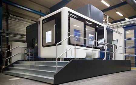

The robust rotary table of the DMU 210 FD can accommodate parts up to 1.850 mm in diameter and 5.000 kg.

The machine has a portal design for the highest precision and dynamics up to 3m/s2.

With 44 kW power and 10.000 RPM on the main spindle, the machine is well equipped to cut even the hardest exotic materials.

DMU 210 FD 5-axis universal machining center with integrated grinding functions.
The tools are stored in a chain type tool magazine. Kurt Andersen explains that they have chosen a version with 120 stations because this way they can store all of their standard tools in the machine – around 80-90 standard milling and turning tools plus the grinding wheels – and they would only need to replace special tools for unique jobs. Kurt Andersen also adds: “The tool magazine can be accessed at any time, so the operator can manage the tools even while a program is running. There is also a second CNC interface here that allows him to constantly monitor the machining process and even stop the machine or issue any command that is necessary.”
