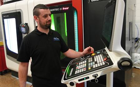

LASERTEC 20 PrecisionTool with operator

The company already has 12 conventional disk and wire erosion machines. However, in March 2015 it added a DMG MORI LASERTEC 20 PrecisionTool, which extended its capabilities from forming the edge profiles to including chip breaker geometry in its PCD tools. Jamie White says, “We carried out trials on several laser machines and we found that the DMG MORI LASERTEC 20 PrecisionTool was the ideal fit for us. Not only has DMG MORI been in the market the longest with this technology, but it uses HSK holders and LASERSOFT software for programming, which is very similar to what we use on the wire EDM machines, making implementation of the technology quick and easy for us. We can make whatever profile shape we like, simply importing a 2D profile into the software and following a question and answer session to arrive at the CNC programme. We found that the LASERTEC 20 PrecisionTool produces a keener, chip free edge and is slightly faster than the conventional machining methods. However, the possibility of adding a chip breaker on our PCD tips, all in one operation, was the main reason for the investment.” As an example, one of Exactaform’s customers was cutting soft aluminium with a carbide tool, where a chip breaker is easy to grind, but moved to PCD once Exactaform was able to supply chip breaker technology.

The LASERTEC 20 PrecisionTool has a pulsed 5-axis laser, is fitted with CELOS and the Siemens 840D solutionline, and has the capacity for 42 HSK tools ready for automatic loading and cutting with the PH 10|100 linear magazine. Changing workpieces takes 30 seconds or less, and with CELOS a queue of work can be automated and monitored to give the ultimate in flexibility for single part and low volume production.
Using laser has some significant technical advantages for PCD as it can work through both the diamond and its binding material, which is especially relevant for course grained PCD grades. Erosion only cuts the binding material, while grinding can cause break-out of the diamond grains resulting in a rougher edge, which affects the quality and life of the finished tool. Furthermore, the production of chip breaker geometry in PCD is straight forward on the LASERTEC 20 PrecisionTool, but impossible with grinding and wire erosion, opening up a huge range of possibilities for Exactaform.
